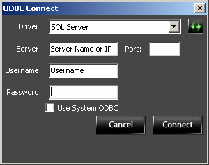

Thank you for providing that information. When using System ODBC make sure to choose "File Data Source". The alternative option "Machine Data Source" is not currently supported as it does not allow connections when the Suite project is sent to a different machine (which does not have the machine data source setup). A file data source is packaged and sent along with the Suite project as it travels across the network (allowing for network portability).
The easiest way for you to connect would be to use the built in ODBC Connect option in the Noventri Suite. You can do this by using the following steps:
1) Choose the "SQL Server" option from the "Driver" drop down. (If this option is not present, the driver can be downloaded from the Microsoft website)
2) Enter the SQL server's machine name or IP address.
3) Enter the Username for the SQL database
4) Enter the Password for the SQL database
5) Enter the Port in which the SQL database communicates on. (You can leave this blank if you are using the default port, which is most commonly the case)
